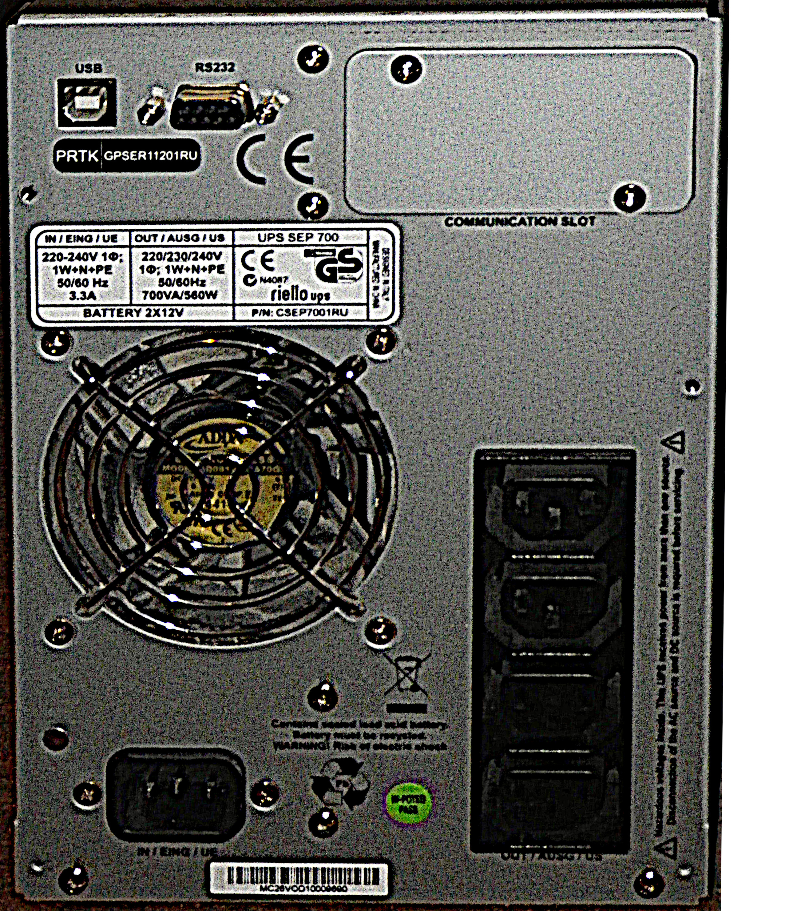

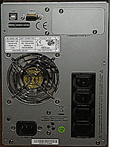

The case is held against the rear panel by two screws on the rear of the UPS. A correctly sized cross-point screwdriver removes them.

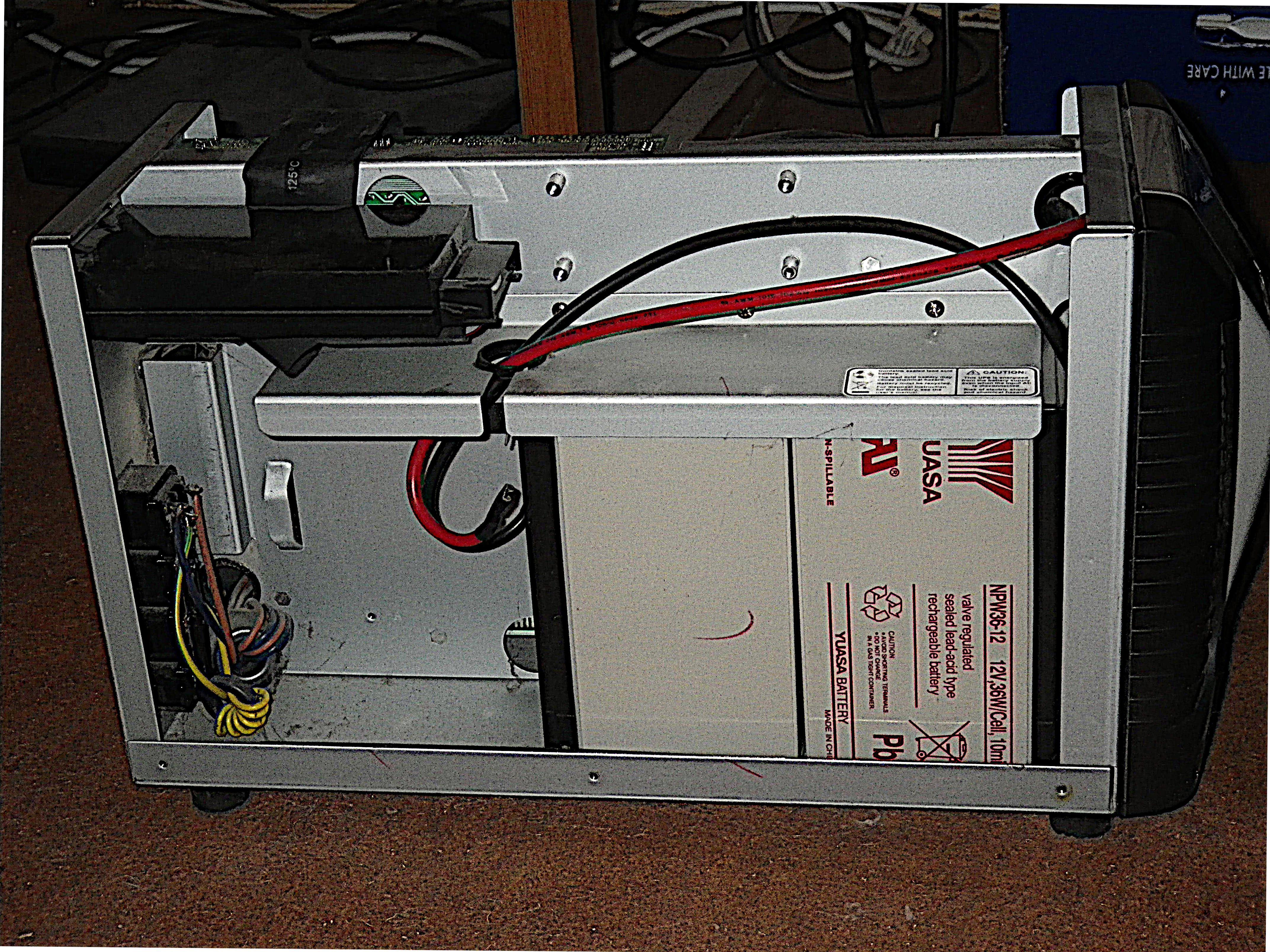

Once you've removed the case you'll also have to take out the alloy plate above the batteries, which holds them in place inside the case. The two batteries are connected in series. Before you take this plate out make notes that record:
None of the wires and terminals are labelled, but all are coloured appropriately. Make notes as you take the plate off: in particular, you'll find a black insulated wire connecting the two batteries in series: be sure to record which terminals it connects.
Disconnect the old batteries and remove them from the chassis.
To install new batteries, just do exactly the same as you did to remove the old ones, but this time do everything in precisely the reverse order while carefully checking that the you connected the right colour of wire to each terminal: get this wrong and, you can easily end up with a dead UPS and a big shower of sparks: the total battery voltage is only 27 volts or less, but SLA (Sealed Lead Acid) batteries can supply a lot of current and alloy plate and/or nice thick wires can get very hot very quickly if they short out a battery.

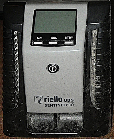

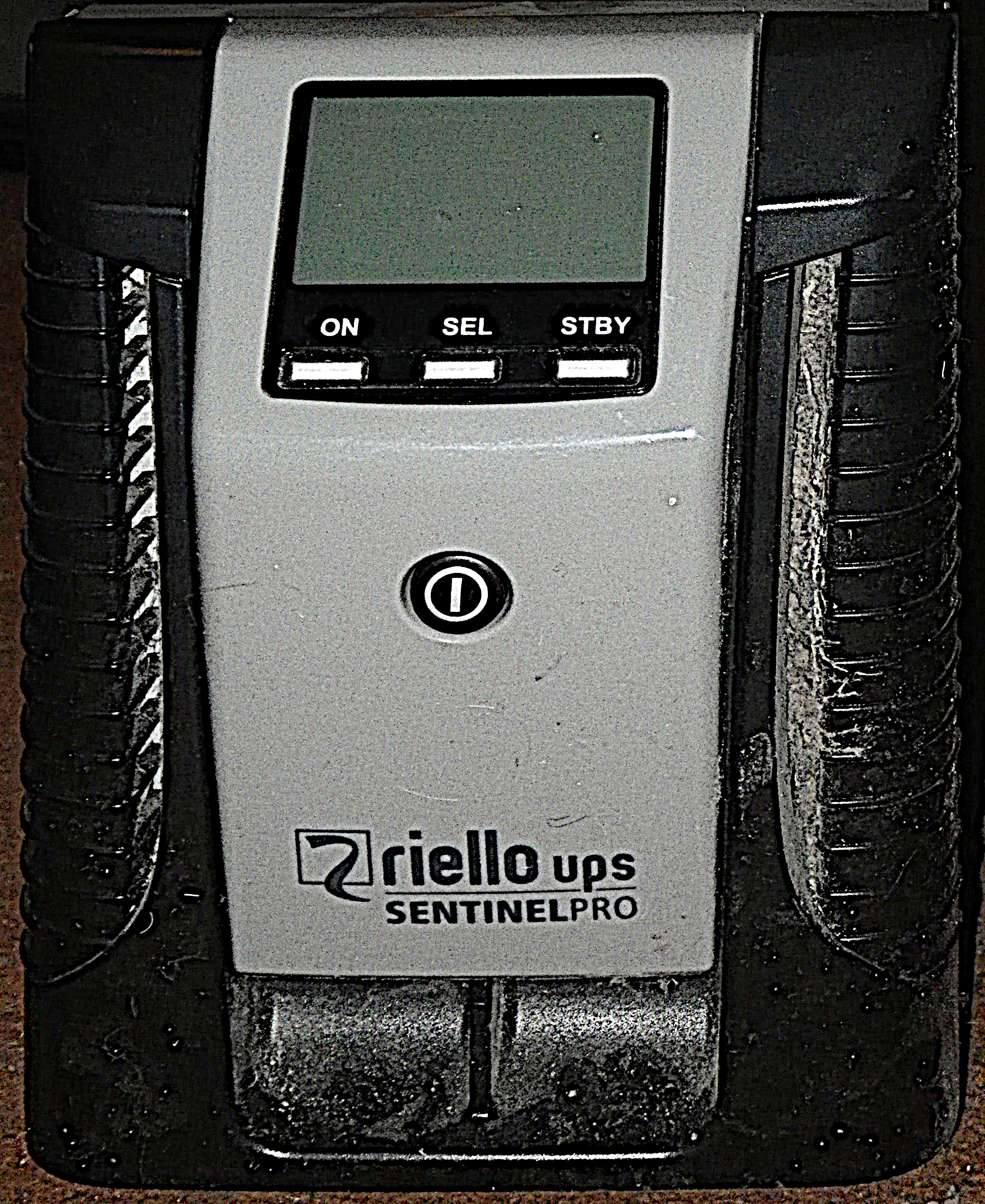

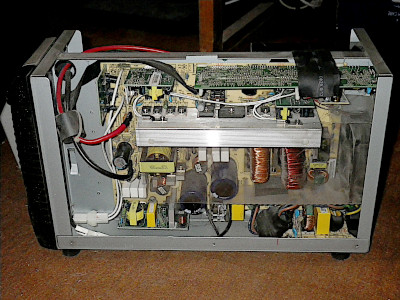

Front of the UPS Front view Back of the UPS showing the UPS monitor connection at top left, mains input bottom left, UPS outputs at right. The two screws securing the case are just under the monitor connection on the left and 1/3 down the right side. Back view

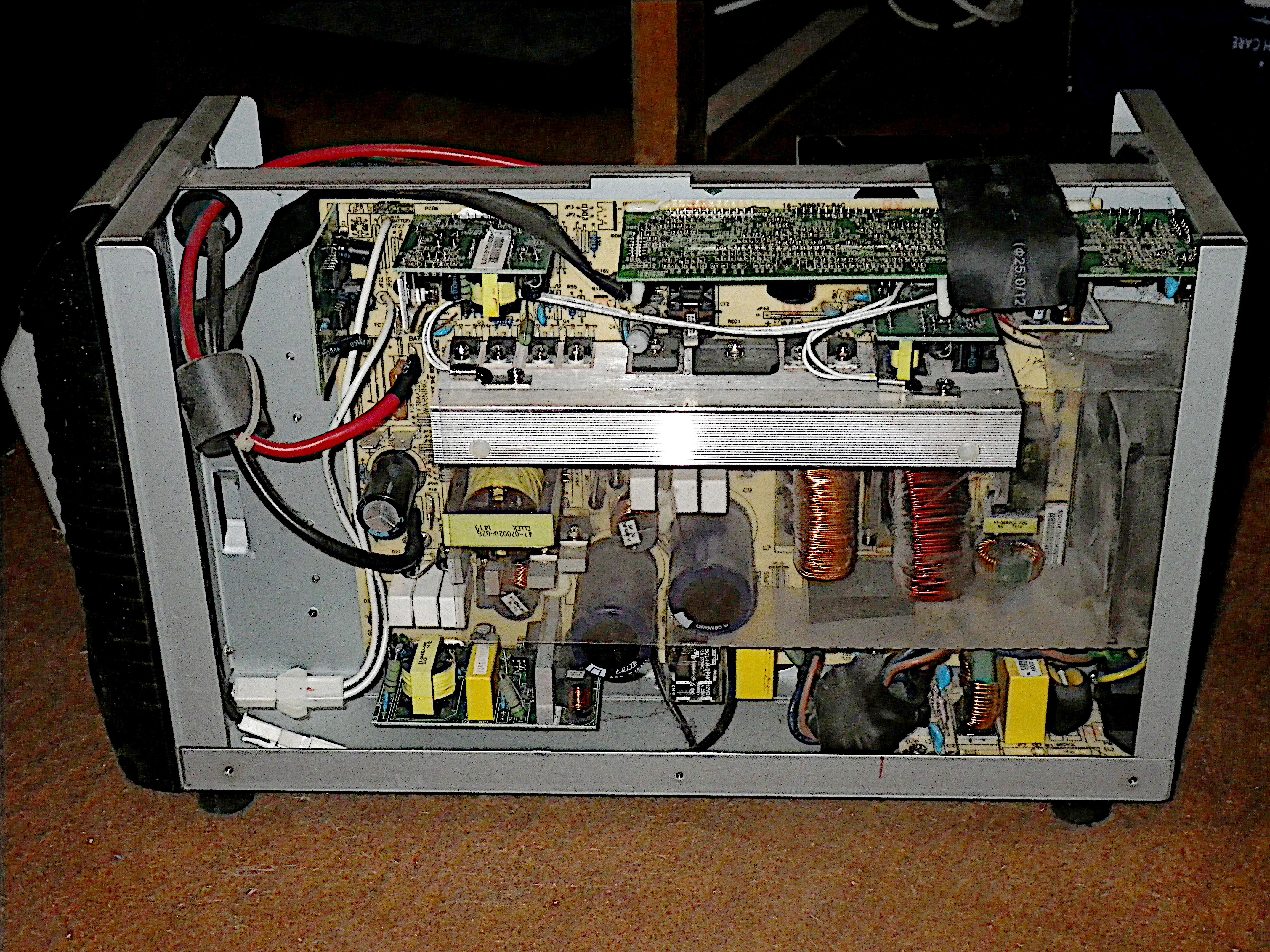

Battery compartment Battery compartment Electronics compartment Electronics compartment
