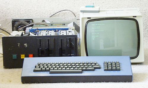

The complete system in its final form. The
cover has been removed from the system chassis.
The display after Flex-09 has booted into the
PL/9 compiler.

When I decided to photograph the system for this page I dug it out, blew the dust off, cleaned the bus connectors and plugged it in. The system ran though the keyboard was initially non functional. As this was a seven bit parallel type and connected to the system chassis by ribbon cable, I initially thought this could be a show stopper. However, after stripping it and thoroughly dousing the key switches with switch cleaner it came back to life and I was able to tell the ROM monitor to boot Flex-09. The system booted on first try and now seems to be in working order despite being 24 years old and spending 18 years in my loft.
