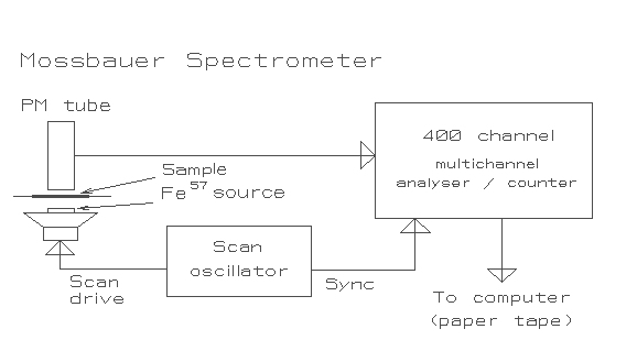

The experimental set-up placed the sample between the source and a scintillation counter (PM tube). A schematic is shown below. The spectroscope, which was built by the Chemistry Department, was quite sensitive to vibration, so the source, scanning mechanism and sample holder assembly was isolated by supporting it on tennis balls.
Mossbauer spectrometer
A Mössbauer spectrometer is essentially a statistical device. The Scan oscillator drove the spectral scan (in our case by driving the speaker on the assembly's resonant frequency to ensure a sinusoidal velocity distribution) and simultaneously provided a synchronising input to the multi-channel analyser. The analyser was stepped at 400 times the speaker's drive frequency so that each channel was recording the same time division (and hence velocity) for the positive half of the velocity cycle. When the Doppler shift causes the emitted energy to exactly match energy levels in Iron 57, which forms 2% of natural iron, the radiation is adsorbed. This causes a drop in the count rate seen by the PM tube and recorded in the corresponding channel of the multi-channel analyser. The system was allowed to run until several thousand counts had been accumulated, thus generating a somewhat noisy statistical spectrum. Initially I used an existing pair of programs to analyse the data, which was dumped to paper tape for input to the university's Elliott 503 computer. They were:
